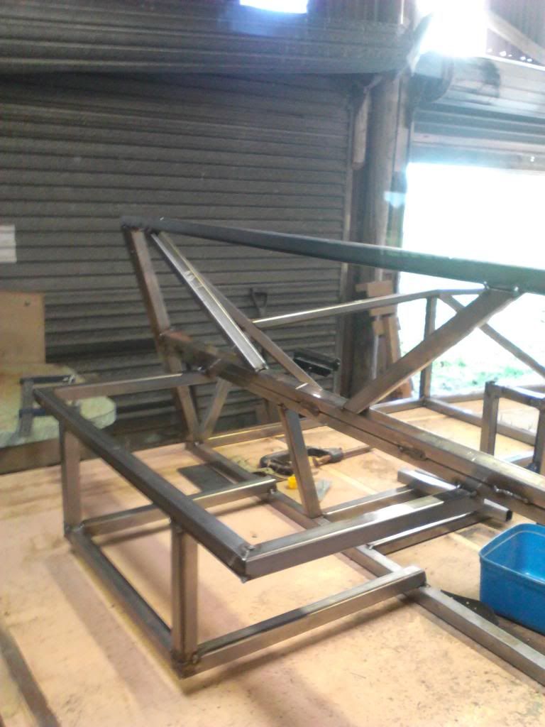

Postby JohnL » Fri Apr 19, 2013 9:05 am

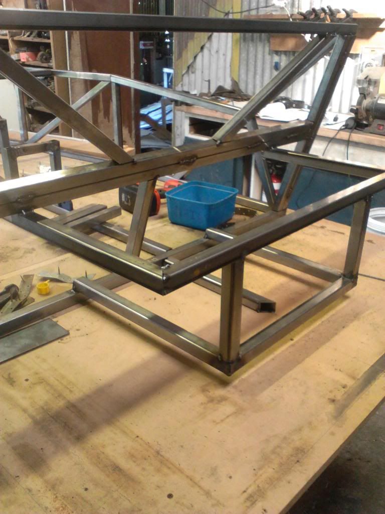

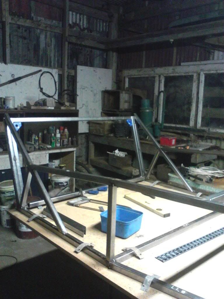

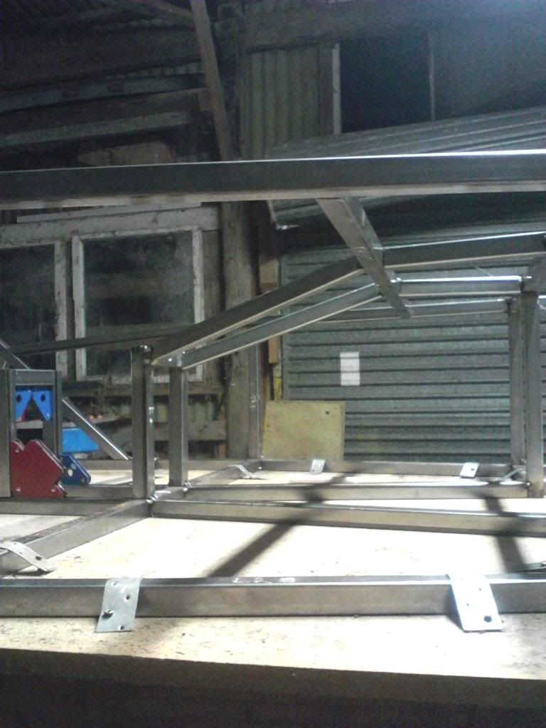

Moving forwards and backwards and then forwards again.... got the top frame tacked to the scuttle only to find it 10mm out of square. Spent a day with the grinder un constructing and now re tacking. Its only 2mm out now.
I have been wondering how to get the seat back rails at the right angle so just jumped into the timber workshop and whipped up a jig to set the angle. Should be a productive weekend.
Also learned the importance of labeling cut pieces as you go, as I have cut one of my long lengths in to many small lengths, spent ages looking for it!
but I must also get some silicon and fix the roof of the as the drops were hitting the build table!

Re: JohnL's build.....small beginings

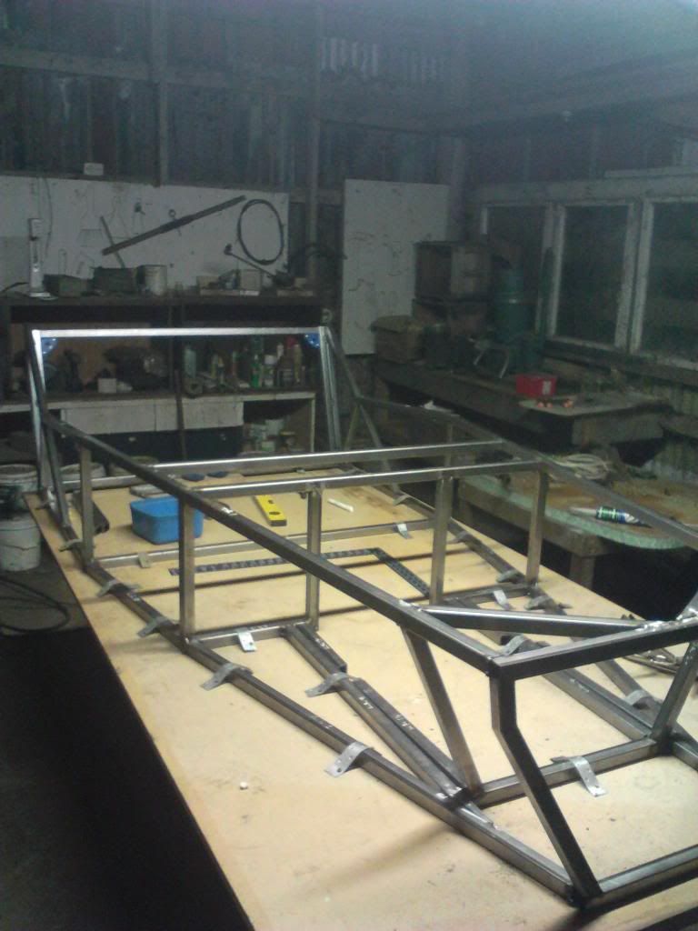

Postby JohnL » Fri Apr 19, 2013 8:49 pm
almost ready to sit in and start the brrrrm brrmm noises :D Its quite exciting to look and say I did that!

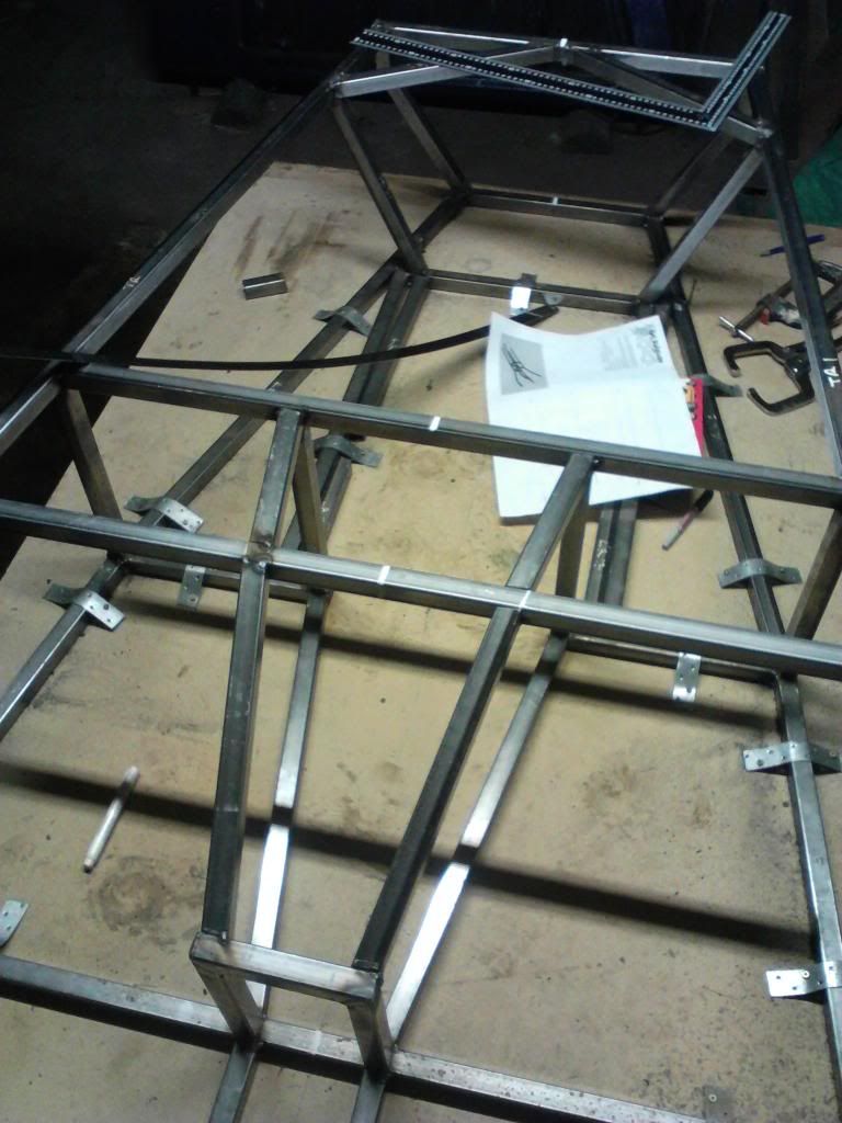

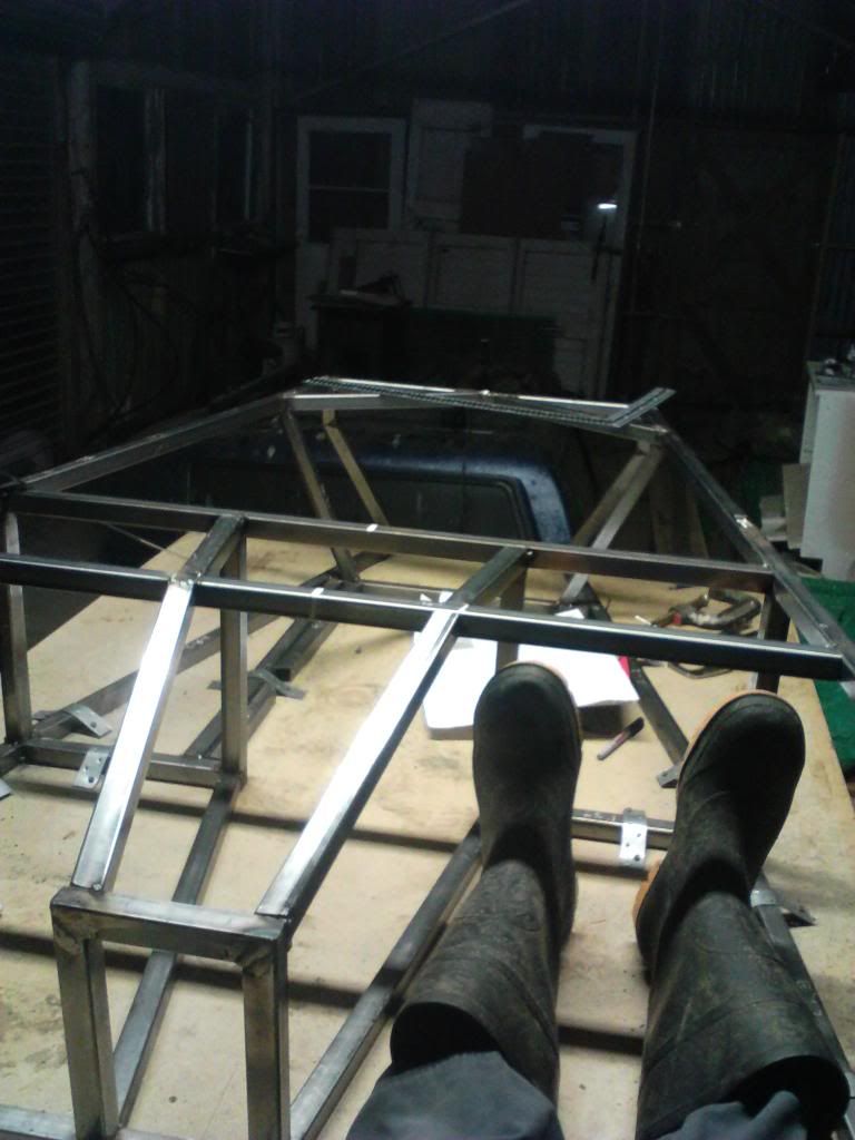

Postby JohnL » Wed Apr 24, 2013 8:49 pm
A bit more time in the garage, working on the tunnel. Sat in it for the first time, heaps of room, and I didnt do any brmmm brmmm :)
Looking at a few other MX5 builds, diff offset is a bit of an issue. Do I need to flare the rear of the tunnel? Im going to spend some time learning some cad stuff now to work out how to build the rear end. I want to use the MX5 rear wishbones so will have to work out the spacings etc
