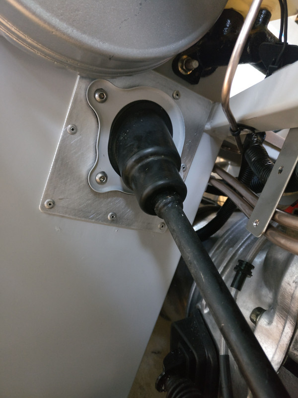

Tidied a little more of the wiring this weekend but started going crosseyed after a while. So gave myself a rest . Fitted the half shafts, after a new coat of paint. Went to lock on the hub nuts and had the flange shatter . I had used the gas tourch on them to remove from donor car, must have made them brittle so have ordered a new pair from the UK. Price 11 UK pounds including postage. Takes about 1 1/2 weeks to get orders from UK. I had also brought some new braided brake lines. 4 days to arrive from Sinapore. With these in fitting diff is is next. Have scetched some drawings for end of brake line brackets . Will make at work during lunchtimes to keep my build progressing. Also have dropped off my rollbar for sandblasting and powdercoating, will be done by tuesday. Have measured the hard brake line lengths and will buy the 3/16 copper/ nickle tube from local brake shop but will do the bending and flaring myself to save money. Fitted the air intake. Usually the MX5 intake goes across the front of the motor, down the left side and sits over the header pipes. Think my way is lot neater and away from hot exhaust. As radiator is offset will get good airflow into intake.

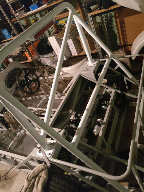

Got the roll bar back from powdercoaters. Bolted onto chassis and fitted highstop light. Started on the hard brake lines.

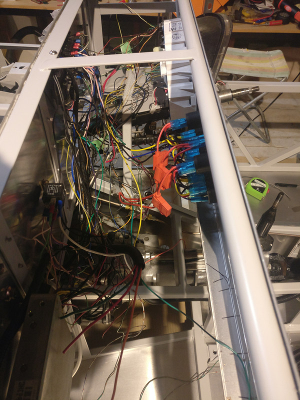

Over the weekend fitted the dashboard with 5mm rivnuts then rivited on the front of the scuttle. Found a full set of wiring diagrams for my mx5 donor car on the net. Started with the simplist circuts first. Completed the altenator charging circut then fitted the window wiper motor ( mx5 ) donor and washer bottle and pump ( Bowers auto parts UK) reusing a rubber bulkhead gromet from the mx5 donor to run the wires up to the switch. Bowers have some very useful bits and I've also ordered some led lights. Coming from UK they are E4 marked so good for NZ to. Also replaced the interior mx5 fusebox with a through bulkhead waterproof one from China. Mounted infront of the instrument panel simplifies things and allows me to shorten many wires.

Been a bit slack lately with updates but been busy helping friend move house and have overseas guests. Life just gets in the way. Have spent the last three weeks working on the wiring and can now see light at the end of the tunnel. Just indicators and brake lights to go. Have been prepared to wait for parts to arrive from overseas to save money. For example a 40amp relay at local shop $27, from China ( free postage) $1.97. I've tried to keep the wiring as tidy as posible around the engine and am pleased with the result but still lots of tidying inside the consol.

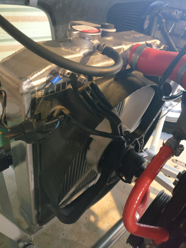

Found some time this weekend to fit an overflow pan and drain to the fuel tank filler. Cut down an old aluminium pot from the kitchen and eventually found the correct rubber gasket for the Jaz fuel cell at Cardwells Auckland, $8. Someone is trying to sell them on trade-me for $6.80 + $41 postage. Fitted a couple of earth leads to stop any sparking from static electricity as recomended by Jaz tanks. Also fitted the radiator fan from the mx5 donor car to the alloy honda civc radiator l'd brought earlier. Turned out to be the perfect fit. Before filling it up with antifreeze thought I'd check the thermostate only to find it was missing! Quick trip to Supercheap fixed the problem. Have also sent an order to China for some PU leather to cover interior panels.
