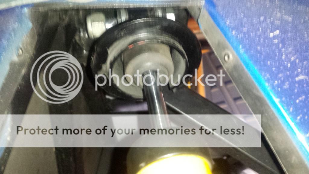

Have you got a photo of the top chassis mount?

Post by mudbasher » Tue Jan 13, 2015 11:47 am
Can get one. Whys that?

I dont think its a shock issue.
I would say its either topping out or there is bind.

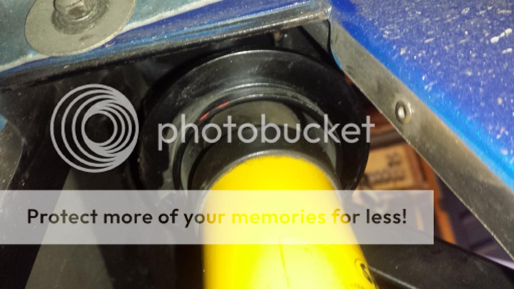

Post by mudbasher » Tue Jan 13, 2015 3:14 pm
Image[/URL[URL=http://s389.photobucket.com/user/1rugge ... 5.jpg.html]Image]
Has clearance per photos. Full compressed & extended. The reason i believe its the bearing is the shock rotates about 5deg through its travel and the bearing is rock solid and unable to rotate causìng the shaft to fatigue and finally break at the start of the thread.
