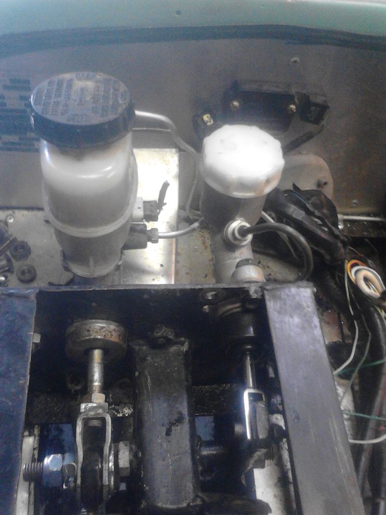

Post by JohnL » Mon Aug 17, 2015 8:00 am
well....... finished, yeah right. Sprung a leak in the rear t connector and at the master cylinder. First the rear T was put in a position that makes maintenance very difficult, so that needed to be moved (new bundy lines from front. Then the master cylinder would not stop leaking at the rear line junction, found to be stripped thread in the master, so out with that. On the shelf in the shed was a nissan master cylinder from what I dont know. So I put that in, but only two outputs so new front bundy needed. My original setup used the mx5 clutch master, but that meant the line in had to go through the brake master. So I decided to change that out also with a trogan trailer master. Also meant I had to add a bit to the clutch pedal to get the right swing as the clevis was about 20mm too short. Hopefully back on the road and stopping by the weekend.
